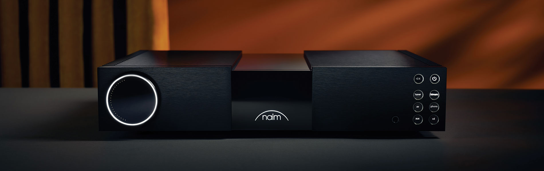

NAC 332
Pure Analogue Preamplifier
The NAC 332 preamplifier is the digitally controlled, pure analogue centre of your system. Each and every audio stage is meticulously designed using discrete transistors, building on 50 years of experience in manufacturing high-performance audio systems. It features a precision fixed resistor volume control and a class-A headphone amplifier, with XLR and RCA outputs.

A timeless design
A timeless design
Naim products are designed to be both contemporary and timeless. Our creations forgo any unnecessary embellishment that would detract from the performance and sound quality. The NAC 332 combines a sleek design, premium materials, adjustable logo brightness and engineered touch points such as the precision raced bearing volume control.

The story of Naim and aluminium
Our founder, Julian Vereker, immediately understood the many benefits of aluminium as a material for wrapping Naim electronic components. He knew that delicate audio components are very sensitive to the effects of magnetic fields, unstable temperatures, unwanted vibrations, etc.
The Naim Classic range maximises this highly technical and durable approach, with aluminium housings rivalled only by Statement, our flagship product. Naim chose a superior-quality aluminium, which optimally combines thermal and microphonic properties. The front panels are treated with solid 20mm-thick aluminium billets; heat sinks frame the side panels and 5mm plates cover the top and bottom surfaces of the products. The aluminium is brushed, sandblasted and anodised to guarantee unalterable beauty throughout the product's life. The New Classic range can be immediately distinguished with one look and one touch, before the first note of music even plays.
